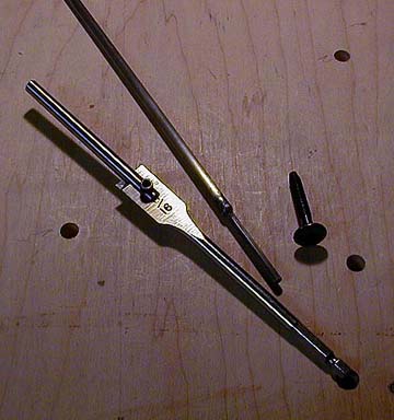

Sorry it took me so long to see this thread! Indeed I do have a tool I use for this, a machinist friend made it for me. Here's a picture of it.
It's a regular drillbit, but he made another shaft that screws to it. I hadn't thought of John Kinnairds' idea, that would be a simpler solution, I'd think! Wish I'd thought of that one.
Also in this picture is a allen wrench that fits the bolt used, and it's welded to a long T-handle. This fits through the endpin hole, and it makes it simple to screw in the bolts when you build a guitar with a soundhole in a different place, or if you use two soundholes.

PostPosted: Sat Sep 17, 2005 2:08 am
I have the same bit as you there Mark, I use it to cut out the truss rod access hole at the head of the neck. Never thought of using it for the bolt hole after the body is all together.
